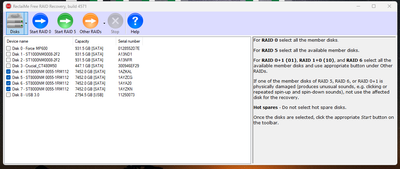

Understood. ReclaimMe doesn't seem to give you the ability to tell it that these 4 disks all should be scanned together. Only one at a time.
ReclaimMe's software for scanning raids requires you to select what version it is, and that does not seem the work either because it is none of the standard versions.
When I look at previews only 15-20% of the image shows. I have to assume it is because how the data is stored on the 4 disks, if I am only looking at 1 at a time... Remember, these are not damaged drives.

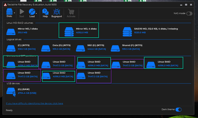

What I want is that 8tb chunk.
You can see the 4gb one is there on the top and that has linux files on it.
Yes, that is RAID-1 (mirrored on all 4 disks).
You need to scan the four 8 TB partitions. Does this guide help?

ReclaiMe Free RAID Recovery is what they want you to run, but it needs you to select a RAID type, which no on can tell me and I don't think is supported. I have attempted to scan on all Raid types, no dice.

The RAID type should be RAID 5.
- markbad311Jan 02, 2024AspirantReclaiMe RAID Recovery fails on RAID 5, 0, 10... I believe RAID 6 also fails, but I am running it again and it has been running for awhile now.
I can recover individual drives and get loads of files but they are incomplete because of the striping. I have to rebuild the raid in order to continue the recovery.
So far I have not been successful.
