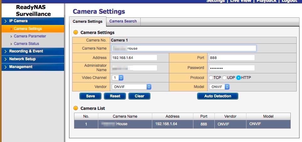

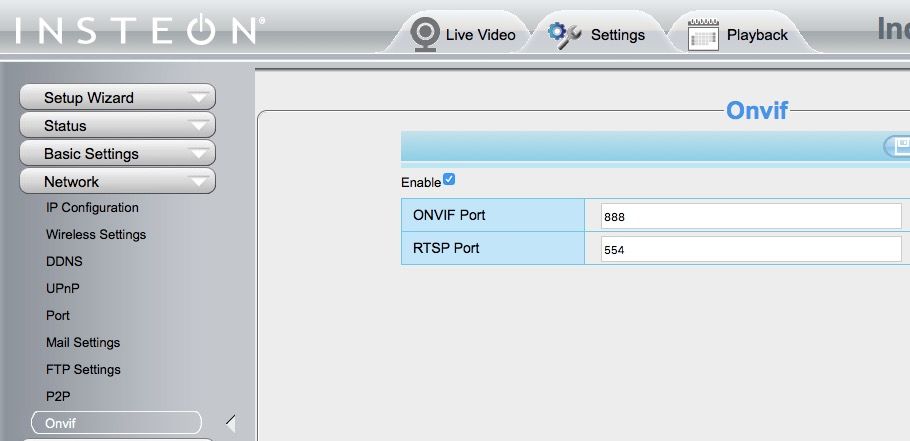

Has anyone had any success getting the ReadyNAS Surveillane software to connect and display vidoe from the an Insteon IP camera, I do believe the camera is made by Foscam. I have version 56 of the camera, there were previous version but this is their latest HD camera. I was able to get the surveillance software auto detect camera on my network by enable the Onvif protocol on the camera and enabling its port. I am trying to see if this works before buying any additional license or cameras. I use Insteon home controls and would like to have it all work together and not have to pay for cloud storage when I have my own home NAS. When I do live view all I get is a black screen. I have the latest version of Java install and I also enable Jave to work when connected to the NAS IP address. At this point I am stuck and can not figure out what to do and whether I have something not configured properly. Any help would be appreciated.
Here are some screen shots of my set up.
