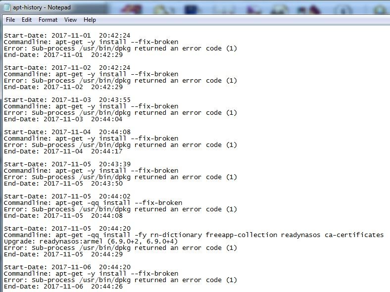

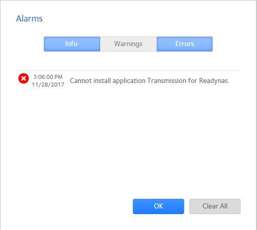

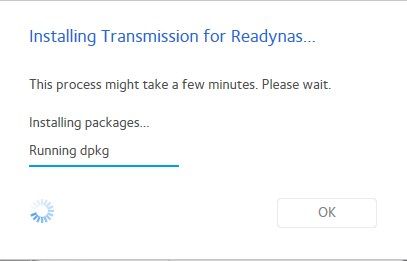

I hope someonce can help when I try to install any app from available apps serction on the admin page it fails and says apps operation failed Application list might be missing or obsolete
I have checked that the device has internet access and changed dns to google DNS 8.8.8.8
After any installation the system restarts ... OS reinstall Does not help!
I have tried install app from deb file.

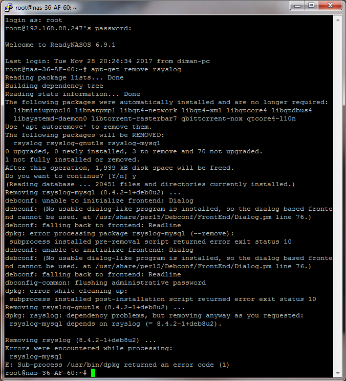

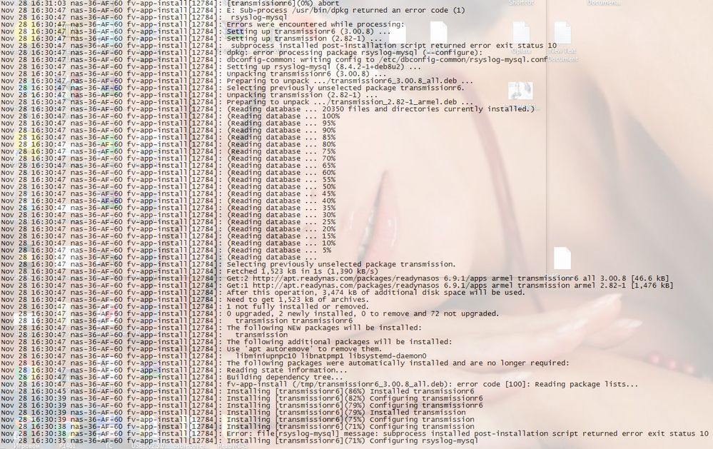

      It looks like you might have installed rsyslog (and that is causing the issues).  Can you try uninstalling that?

      Chrome, Mozilla, IE - Don`t work. I think that it`s bad assembly NASOS / Maybe need the firmware downgrade?
