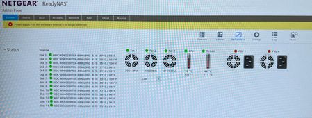

RR4360X Power Supply in enclosure internal is no longer detected
Out of the blue, our RR4360X started reporting the PSU are no longer detected, while they are in and working thankfully Tried to unplug and plug to refresh state - no result Tried to change PSU slo...
