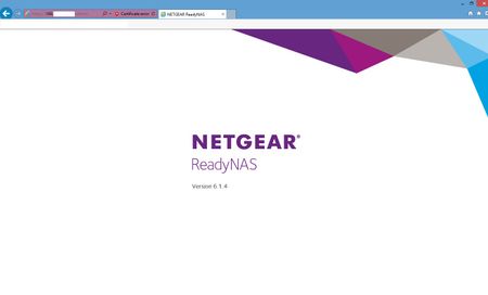

The 169 address (which I think I can see a piece of in your screenshot) generally means that the NAS is unable to get an IP address from the router.
Your firmware is extremely old, which does get in the way of troubleshooting this. Newer firmware would have let you download the logs from RAIDar for instance.

The NAS. Your RAIDar screen shot shows it is running 6.1.4, the current firmware is 6.5.1. There are a lot of changes - if you don't have a backup of the NAS you should definitely make one before you upgrade.
