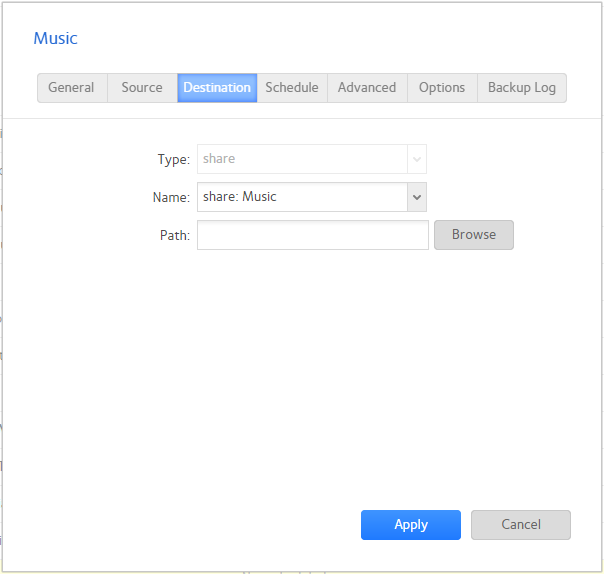

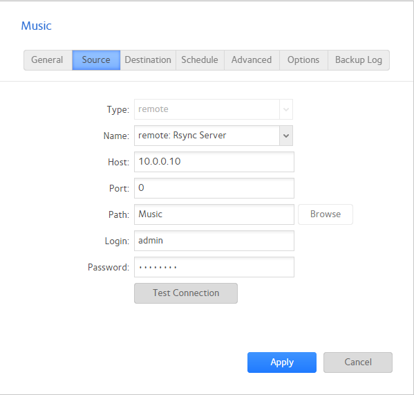

Yes. rsync also lets you control the destination share.

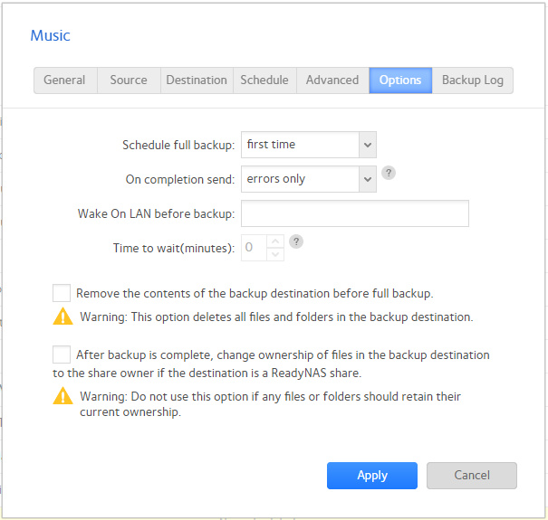

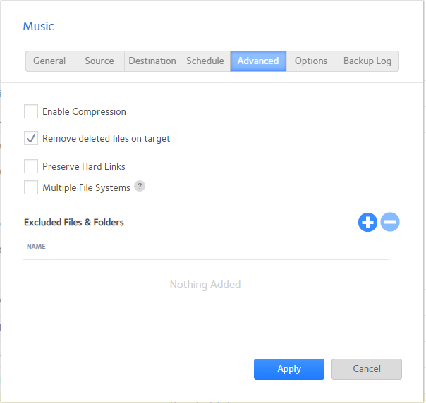

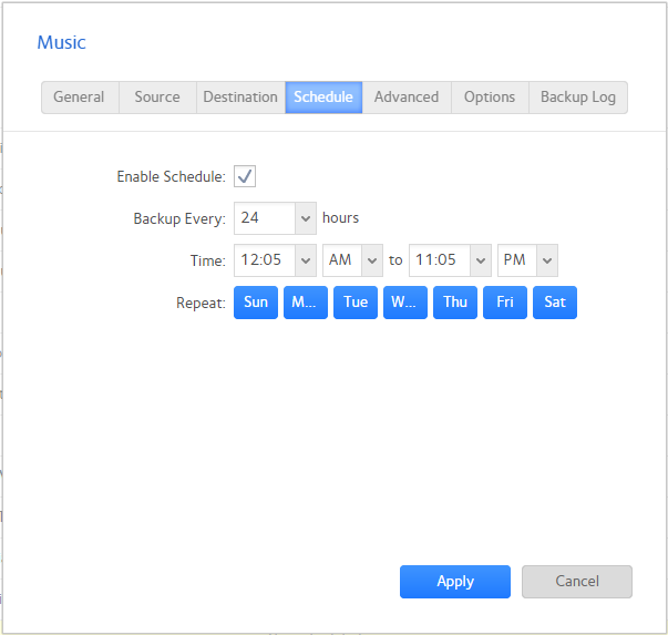

Here's some screen shots from one of my daily backup jobs (backing up Music to another Music share). These are "pull" backups - running on the destination NAS.

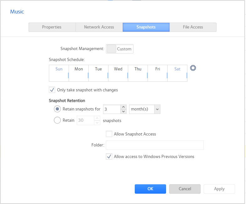

I also use custom snapshots on the destination to give me some retention (e.g. the ability to recover an older version of a file). Longer retention will result in more disk space being dedicated to snapshots. Personally I use 3 months for most shares. I never use the default "smart" snapshots, as they have unlimited retention - over time you need to delete snapshots manually if you use the "smart" settings.
You can also use snapshots on the source share of course.

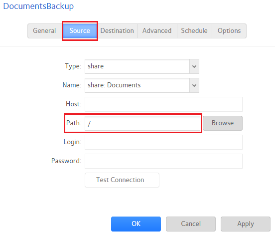

If you decide to use a push backup, then make sure you put a single / in the source path. That is shown here in step 16:

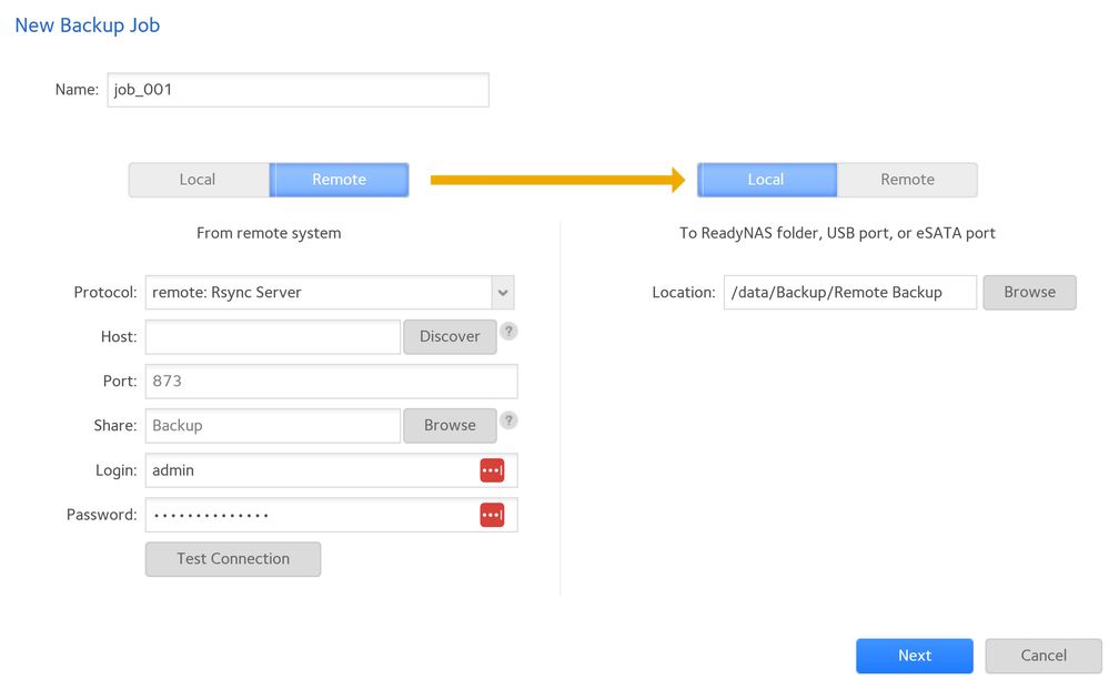

I don't see quite the same screen.
I try to use
remote
remote: Rsync server
Host ip (the ZeroTier managed IP)
Port - not sure about this one
Share - I can't seem to make this find anything to back up, I get Connect as and then I can enter admin and password but no paths or folders come up
Login - admin
Password my password
I am using ZeroTier 1.1.14-nt3 if that helps. Both of NAS's are using ReadyNAS 6.10.8.
I get all of the helpful info about push and pull but I don't quite seem to have cracked the basics yet! Thanks all for your help so far! - StephenBJan 23, 2023Guru - Experienced User

Put in the IP address of the remote NAS in the host field, then click next.
After you go through the wizard, edit the backup job settings and you will see the screens I posted.
- SadNationJan 23, 2023Tutor
Hi all
I am stoopid! Once I turned rsync on read/write in the shares as well as in the main settings, each NAS could see the other NAS's shares! I think I have it all set up now so thank you all for your help!
