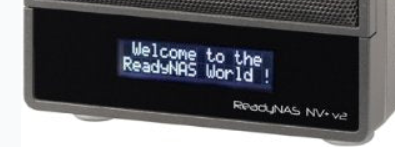

        Thanks StephenB, I'm piecing this together.  It looks like the v1 was very popular (lots of them on marketplace websites) and not many samples out there of the v2.  Another way to look at this is perhaps the v2 was very reliable and no one is selling them  🙂
        So if you could bear with me and just confirm if I've got this correct,  the 'front panel' is this badge on the front panel.  Anything that is simply "ReadyNAS NV+" is a v1 and I can disregard the various part codes listed on the serial number/barcode sticker on read or underneath showing RND4000, RND4000v2, RND4000v3 etc:
        And from what I've seen of photos, the "ReadyNAS NV+ v2" is a darker colour grey but clearly shows the 'v2' in a different location on the front.  Again, the serial number/barcode stickers for a NV+ v2 will still list it as a RND4000 and should be disregarded as evidence.
