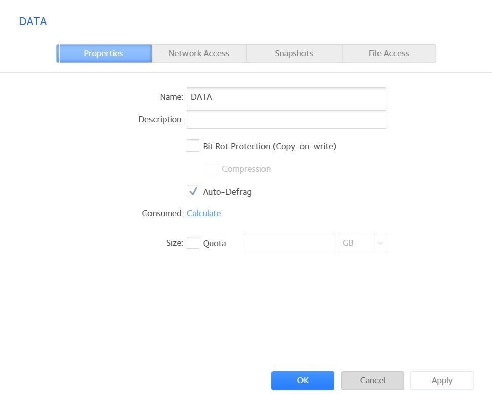

      I've noticed the Shares are set to auto-defrag, is this different to volume defrag? should I also enable Bit Rot Protection?
        It's the same defrag process, just run for the share instead of the entire volume.  I don't know what triggers auto-defrag to run.
        Personally I enable it.  It enables BTRFS checksums on the share, which would give you some more information on what files are damaged if the disk starts to fail.
