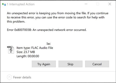

Difficulty accessing Readynas with windows explorer
It is not that I can not access it at all. It is just I can not maintain a good healthy connection. Have the Windows 10 firewall turned off and restarted the PC. Still have this problem. Of...

As always, Thanks to folks for the time offering help.
The ethernet cable is to blame.
