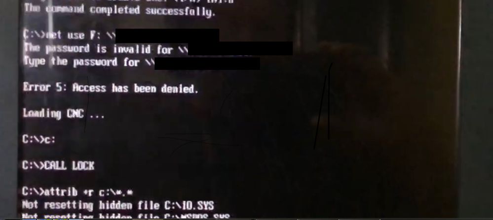

Hello,
I'm trying to map a share from our new ReadyNAS 3138 with DOS 6.22 running on a CNC machine but have access denied issues.
The machine was setup and on the network just fine with our previous server. I've mapped the ReadyNAS IPs to server names in Hosts and LMHosts and I'm able to ping the ReadyNAS. I'm able to map the share using net use under CMD from windows 10 workstations.
I've create a user and tried with the specific user's credentials but again received an access denied error. Within the ReadyNAS I've got the share setup with everyone (and tried adding anonymous) permissions along with everyone setup under network access and file access permissions but still receive the access denied error. On boot the error is a "you were logged on but have not been validated by the server" and then an "invalid password" error. The password used is correct.
From DOS I've got net setup with user name, workgroup, correct driver and TCP/IP protocol. Autoexec.bat has the proper net use command. I've tried using net use with the IP but it prefers the server name.
Any ideas?

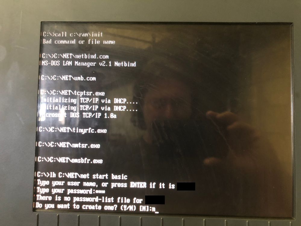

      And you are sure that the old server was using NetBIOS over TCP/IP, not over NetBEUI or some other protocol?  It has been a long time since I messed with networking on a DOS machine, but not as long as some.  We also still have DOS based equipment where I work.  But when they blocked all the protocols that DOS supports on the corporate network, I had to change them to dual boot with a server upload/download performed via Windows and the machine software run in DOS.
      What does NETSTAT -A  return?  Can you turn echo on during the execution of your AUTOEXEC.BAT and post a screen dump of when the networking commands are executed (obfuscating the user name and password if you need to)?

        I'm using NetBios over TCP/IP (listed as Microsoft TCPIP in net setup).
        We don't have enhanced commands in DOS on most of our DOS 6.22 based CNC machines - unfortunately, no NETSTAT.
        Net use paths are F: \\server_name\share. I tried a few different ways to set this up and found DOS prefers server names (does not like IP address) and the user must be setup under C:\NET\setup rather than added into the net use command (although I can set a password with net use).

  • Sorry for the extra photo posts- they are not needed.
    Looks like it's an issue resolving host names. Even with entries in Hosts and LMHosts I'm unable to ping server names (ips ping fine). Pinging local host is able to resolve so Hosts file is working.
