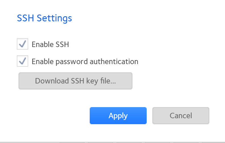

Enable ssh on the NAS (system->settings->services), checking the box that enables password authentication.

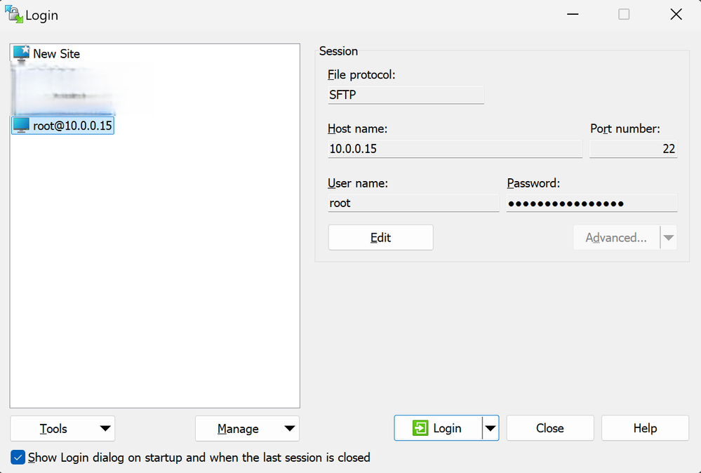

Set up WinSCP to connect with SFTP to the IP address of your NAS.

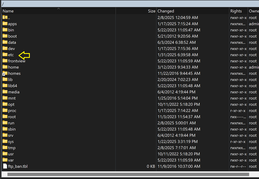

After you connect, you should see something like this in the right pane:

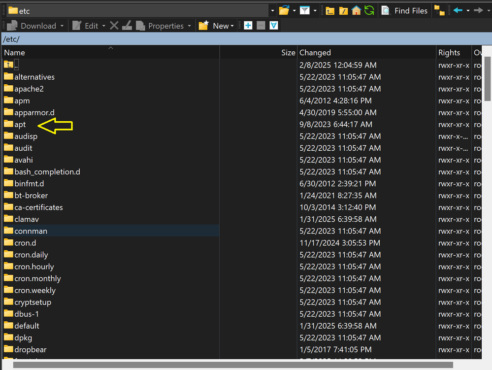

Click on "etc", and you should see this:

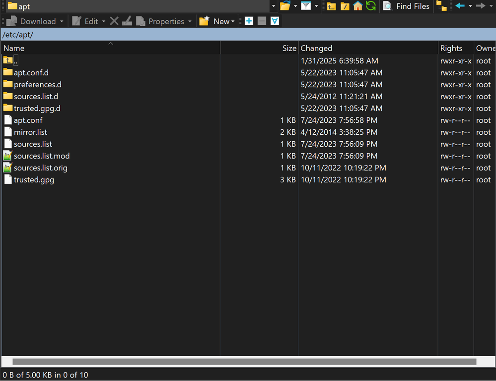

Now select "apt":
You need to copy the two files you downloaded into this folder (just drag them into the pane).

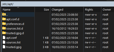

I have copied those 2 files as you have described here is what the file structure now looks like...I have restarted the device and checked on the web interface in the apps section but it is still blank...
before i do anything else and knacker it all up, what is the next step? and thanks again for the help!
