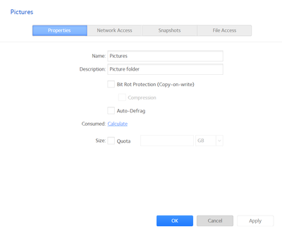

Another thing I just noticed is that on every share, on all 4 NAS boxes, these options are NOT checked on any share:
- Bit Rot Protection
- Auto-Defrag
Are these important? I imagine they may slow the NAS down at times, but I thought Bit Rot Protection in particular was a key feature of these NAS boxes? Didn't realize I have to manually enable it on every share. Since it's OFF by default, now it makes me wonder if it's even a good feature to enable.
Auto-defrag seems like a good idea in general. Thought Windows does some auto-defragging nowadays, doesn't seem to slow things down noticeably.
