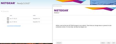

I have tried using the RAIDar software did not find it. If I use ReadyCloud to discover picks up 2 NAS 316 but will not find the 2120v2

I have removed all the drives and powered the 2120 chassis on same lights have come on. Device has not come up in RAIDar and when I look on ReadyCLOUD only showing the NAS316. I am to able to do a ping to the IP address that is assigned to the 2120 from my computer or access the ReadyNas adminpage
