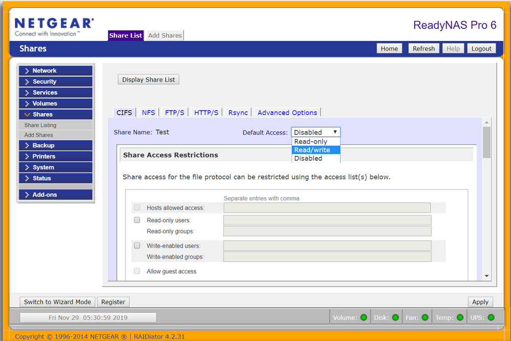

“@Lionel1020wrote:
I can find the share names “backup” and “media” in the Share Listing section. CIFS is disabled for both.
CIFS needs to be enabled for both, not disabled.”
****My comment was not clear, I know they need to be enabled...but I don't know exactly how to enable them....
“@Lionel1020 wrote:
Trying to allocate the file protocol there is 'tick-box' that asks what “Hosts” are allowed access...
Leave that tick-box unchecked. ”
****I am not sure of the exact meaning of the word “Hosts” (as it is used here).
****What is a “Host”?
****And what are/is the “file protocol(s)” they are referring to?
I believe if we can enable CIFS this will give access to the shares 'media' and 'backup'.
The 'tick-box' would need to be checked, this would allow you to add the names or addresses of the 'hosts' in the box headed “Separate entries with comma”
This is where I'm stuck:
*I don't know what a 'host' is....
*I don't know what the hosts name or address looks like or where to find it!
*I don't know if we enter the name or address ….or both...or something different!
Lionel
StephenB
Nov 29, 2019Guru - Experienced User
Select read/write in the pulldown as shown above. Then click "Apply" on the bottom right.
No, it doesn't need to be checked. Leave it unchecked. You don't need to enter anything in hosts allowed access.
The hosts list is an old mechanism to let you enable CIFS access for specific home PCs. So if you only wanted one of your PCs to access the share, but not the others, then you could enter the PC's IP address you want to allow in this field. Or you could enter the PCs name.
It's not a very useful security mechanism, since IP addresses normally will change on a network, and the addresses/names can easily be spoofed.
A better mechanism to limit access is to enable users (or groups) either for read-only access or for full access. That is based on the user login information. But that isn't normally needed either on a home NAS. It's best to just enable read/write access by default as I show in the screen shot above, and leave the hosts, read-only users, and write-enabled users fields empty. If you want to lock down access more tightly, then do that after you actually get access from your home PCs - not now.
- Lionel1020Nov 29, 2019Aspirant
