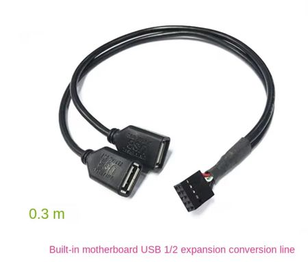

For those interested to install alternate OS
10-pin motherboard USB to regular USB flash drive adapter This is the adapter I bought and it works. Simply remove your daughter board and store it for backup. Plug this and extends to the ...

It is not easy to find the 10-pin module. Most of them are 9-pin.
and the orientation of the pins looks different as well. It is odd though
- schumakuAug 10, 2024Guru - Experienced User
No need to find the 5x2 modules, with or without the empty index hole. Two 4x1 or eight 1x1 are sufficient. Nothing odd at all. Just have to connect these correct...
This is a typical example with a 4x1
