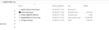

    Hi again,
    fixed it! Finally it worked for me! Got my unit to work again after many different FW version flash tries. At the end I've used this USB stick:
    and VERY IMPORTANT do not eject/remove your original disks from the system. The FW upgrade can not start, when the org disks are pluged into the system.
    No strange marvell - folder is required. 6.4.0 is much faster than before and many usefull options are included now.
