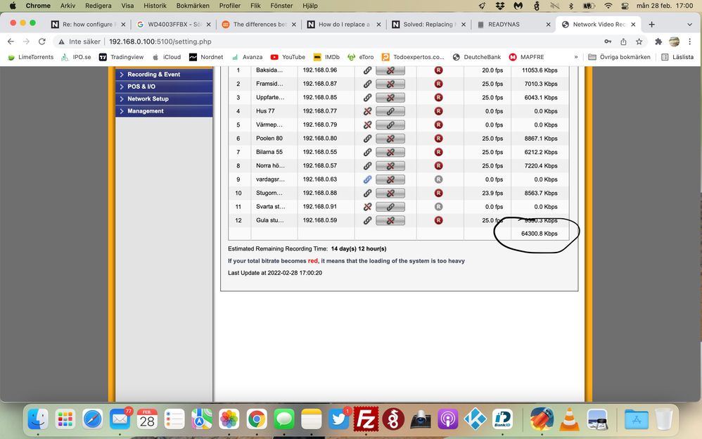

The surveillance program tells me that when all the cameras are on the bitrate is 66000 Kbps.
In your opinion should i go for new disks or 10gb network to my client?
66 megabits per second? Or 66 megabytes per second? Both can be handled comfortably by a gigabit infrastructure, but it still would be useful to know (see below).
I am thinking now that the main problem is the SMR drives. They depend heavily on caching, and when the caching isn't enough the write speeds get really really slow. If your cameras are always recording, the caching definitely won't be enough.Playing with RAID modes (or settings) probably won't overcome this.
So I'd go for new disks over a 10 gb network upgrade.
mangebest wrote:
..should i maybe go for SSD?...
They would of course be much faster, and much more expensive for 4x4TB. Performance with SSDs would be limited by the network, no matter what RAID mode you used. You do need to pay some attention to the write limits.
Four 4 TB Samsung 870 drives would cost you about $1700 (current US amazon price), and each drive is spec'd at 2400 TB worth of writes over its lifetime. Assuming 66 Mbps from the cameras, you'd be writing about 1 TB per day (counting RAID-5 overhead), spread evenly across all four drives. So about 250 GB per drive per day. Over the 5 year warranty, that works out to ~460 TB/drive (and it would take over 20 years to reach the write limit spec).
But 66 MBps would be 8x the load - about 7.6 TB/day total, or roughly 2 TB per drive per day. In that case the drives need to be replaced about every 3 years. That is why I asked about the units above.
The write limits do vary, so you'd need to get this info for the specific SSDs you purchase. (BTW, the Samsung 2400 TB spec is only for the 4 TB 870. The spec is lower for smaller SSDs).

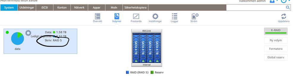

that would be wonderful, but will it work when i have RAID 0 ?
Can i just replace two disks and let the two other bays be empty?
- StephenBFeb 28, 2022Guru - Experienced User
You can't change to RAID-0 unless you destroy your current volume. And that will create the problem with ReadyNAS Surveillance.
Also, you can't shrink an XRAID array from the NAS admin UI - so you won't be able to reduce the number of disks in your existing volume.

I think i got my RAID confused- seems i have RAID 5 and that would mean i can change disks one at a time?
