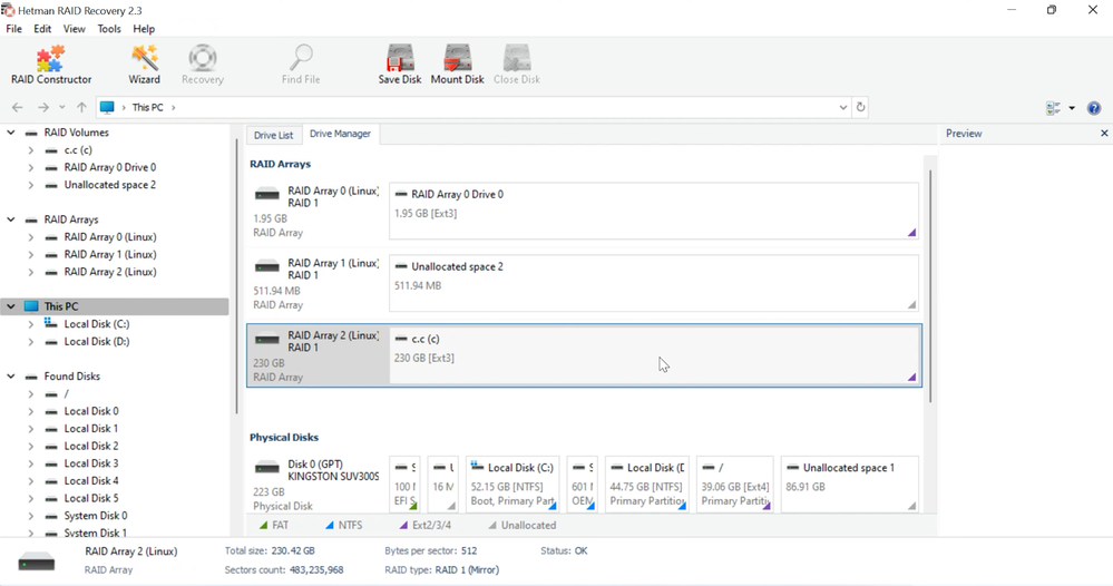

  • Got it. I will definitely try R-Linux.
    But I already managed to try Hetman RAID Recovery (https://hetmanrecovery.com/raid-data-recovery-software) in the same way. It seems to me that programs work in a similar way.
    As you can see in the screenshot, the program has identified the partitions of my raid array. After scanning it, the files are available.

    • valerym's avatar
      valerym
