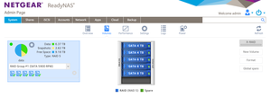

I have 2 volume groups showing, after adding a disk- is something wrong?
Sorry - this will be a long post to explain what I am seeing. I want to know what I should do about this situation to best protect my data. I have an RN426, and I had 2x 4TB and 2x 6TB drives con...

I have tried pressing the XRAID button but I get an error : "You are attempting to switch from Flex-RAID to X-RAID. This is not possible because you have expanded volumes."
If I end up with 3 FlexRAID groups, (2x 4TB, 2x 6TB, and 2x 8TB) is there the possibility I may be able to then force it back into XRAID myself with the XRAID panel button?
is my /data volume now spread across the two volume groups or just on one of the volume groups? I'm confused?
If I remove my 2x 4TB drives, leaving the 2x 6TB and 1x 8TB (in otherwords keep Group 2 in the NAS physically) could my /data volume remain intact? If so, could I then try forcing back into XRAID, and adding the new 1x 8TB disc to that set?
I was afraid you might see that. Whatever pushed you into Flex-RAID must have happened either before you inserted the 8 TB drive, or during the expansion.
First of all, they are called RAID groups - not volume groups.
I tried to explain this before, but apparently it was too confusing for you. Maybe think of this as a wedding cake. The bottom tier is 5x4TB RAID-5 at the moment, and the second tier on top is 3x2TB RAID-5. When you add another 8 TB disk, the bottom tier would be 6x4TB RAID-5, and the second tier would be 4x2TB RAID-5. With X-RAID, the system would automatically create a third tier in the "cake" of 2x2TB RAID-1. And when you upgraded an existing disk to 8 TB, it would convert that third tier to 3x2TB RAID-5.
All of these cake "tiers" are concatenated into a single BTRFS volume.
As I also tried to say before, your data was spread over these two RAID groups before the system switched into FlexRAID. Your original 2x4TB+2x6TB volume also had two RAID groups what were concatenated together - a 4x4TB RAID-5 "bottom tier" combined with a 2x2TB RAID-1 "second tier".
All X-RAID does is automate the RAID group management - so you don't need to think about it. Flex-RAID gives you full control over it (and it does let you choose RAID modes that X-RAID doesn't use). So you can certainly follow through on your plan with Flex-RAID, you just need to read up on it a bit more, and of course follow up here if you don't fully understand what you are doing.
Still, it is a bit of a mystery on why the system jumped out of X-RAID mode in the first place.
No. Removing two drives from your array will result in immediate loss of all your data. Removing one disk will give you a degraded volume - making your data more vulnerable. Don't try manipulating your disks, it won't help and almost certainly will hurt.
No. BTW, you couldn't end up with that set of RAID groups unless you destroy the volume and start over. Hopefully the explanation above makes that clear to you. You'd have a 6x4TB RAID-5 group (all 6 disks), a 4x2TB RAID-5 group (6 and 8 TB disks) and a 2x2TB RAID-1 group (8 TB disks).
