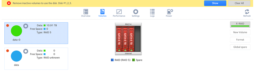

Hi,
My ReadyNAS 214 recently powered off and after turning it back on it now shows the three volumes that I have in the colour Red. The markers are green which makes me assume they are fine but I don't know why they are showing up as Red.
I've tried booting in Read-Only mode but this hasn't worked. I've also updated the firmware. I'm currently running:
Firmware: 6.10.7
I've been running X-Raid and I really need to get some of the data off some of these drives at the very least. Any help would be really appreciated as I'm panicking a bit and don't know what to do.
Can I get a SATA cable and connect these drives directly to a laptop if I can't access it through the NAS? I'm happy to provide logs and anything else that might be of use to help this.

Bigmaca wrote:My ReadyNAS 214 recently powered off and after turning it back on it now shows the three volumes that I have in the colour Red.
Be careful on the vocabulary. You have one data volume (currently inactive), and three disks. The three disks are red because they are not part of an active data volume.
Was the shutdown graceful, or was there a sudden loss or removal of power? I am thinking it might be the latter. That can create an out of sync volume, due to cached writes that were lost when the power failed.

Bigmaca wrote:
Would a possible reinstall of the OS fix this issue?
No, that won't help at all.
There are a few possibilities -
- the RAID array might be too far out of sync to mount manually. It can be "forcibly" assembled,
- the RAID array might be ok, but there might be some BTRFS file system corruption which is blocking the mount.
If (2) the corruption might be repairable with normal BTRFS tools. Or actual data recovery might be needed.
Based on what we know at this point, I think there's a good chance of avoiding full data recovery.
