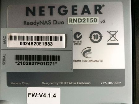

Identifying which ReadNAS Duo I have
Greetings. Apologies if this appears twice. I have a Readynas duo into which I want to put a bigger disc than 2gb. The label seems to say "ReadyNAS Duo RND 2150 v2". See pic. I cannot tell wh...

Aha! That sounds convincing. So I am stuck with 2TB :-(
Do you know whether using a bigger drive (e.g. 4TB) means a) that it won't work at all or b) it can't see more than 2TB?
Many thanks, Nigel

You definitely have a v1 (sparc). The 4.1.4 firmware label in your picture is a clear signal. The v2 on the rear label means "hardware revision 2 of the V1". Very confusing - they should have changed the name (or at least the model number).
Many thanks, Nigel
Usually it sees something like 768 GB. So you need 2 TB or smaller drives.
