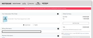

Hi all I am trying to purchase a support package but it won't let me purchase because our region isn't the same as the currency, but no option to change currency. Does anyone know how to purchase su...

eve-gcm wrote:I am trying to purchase a support package but it won't let me purchase because our region isn't the same as the currency, but no option to change currency. Does anyone know how to purchase support??
I think you will need a mod to help with that. DaneA ; JeraldM : can you assist???
