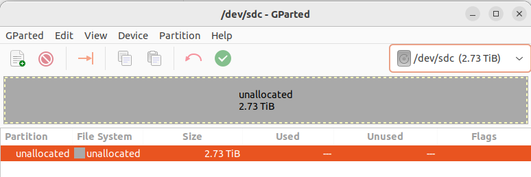

Water got onto my nas from the floor above, not submerged, and it won't boot with the disks in it. So, I'm trying to learn how to mount one of the RAID1 drives from another machine and copy my data o...

I had tried using gdisk commands on the first of the two drives using the old SATA connector and I think I messed it up. Even with the new connector, is shows one large unallocated partition.
Yes, it looks like you accidentally repartitioned that.
