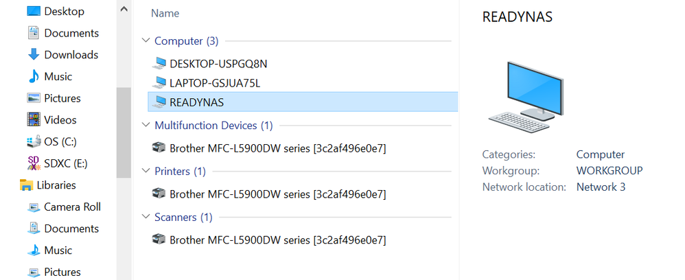

I was using my RN202 just fine, including access through ReadyCloud, inside a network where it had an IP address of 192.168.0.x.  Our lease terminated and I had to move it to a new network that was already set up with 192.168.1.x addresses.  Inside the network, I can still access the files on it just fine (Windows explorer sees it on the network just fine, and the mapped drives on the computers that also moved to the new network see it), but I can't get into the admin portion of it anymore to try and change the IP address (e.g., by typing the 192.168.0.x address into Chrome), and of course ReadyCloud doesn't work either.
Any suggestions?

      Thank you for your quick response.  I was under the impression that I had set some sort of static IP in the device, but it was a long time ago and since I can't ping it, you may probably correct and it has picked up a new DCHP-supplied IP address in 192.168.1.x.
      As for "talking to the network admin to make a reservation for the RN202 MAC<->IP pair, so it will keep the same IP address on the new network," there isn't one, so I have to  figure this out.
      The problem is, I have enabled those two services you mention, and I still can't see the Properties (Eigenshaften) for the NAS box; I get the picture below, and the Properties button is greyed out if I highlight the READYNAS box.  There is no '"Storage Device" to click on to get into the admin interface; whatever I cleck on ("READYNAS") just sends me into the folders on the box.  So I still can't figure out what IP address it is using and have no way to get into the admin interface.
