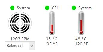

This looks to be a bug in 6.6.1 using my Ultra 6 (legacy) NAS. And I can't make sense of what is wrong: We have a ducted air conditioned house at around 25 degrees ambient My "CPU temperature" s...

Sensors is correct, and actually the graph is correct (though admittedly difficult to decipher). If you look closely, you'll see that the darker color you interperted as the System temp doesn't match the color on the legend. This becomes clear when you look at the Last, Avg, Min, and Max numbers -- they match the gauges at the top, and of course the sensors output as well. The legend appears to be defining the color of the thin bar at the top of the graph line, rather than the fill color.
So, this all matches up, and is completely normal. The CPU temps are based on the DTS (digital thermal sensor) readings, which get less accurate the further away they get from the upper limit (which is 100C on Ultra 6). We put an aritificial floor in there at 35C, because it would be even more confusing for people to see a CPU temp reading of, say, 8C, which is what we actually get from the CPU DTS reading. It's very difficult to get these Atom D510 CPUs anywhere remotely close to 100C, especially on a system with good thermal design and a fan that's always running, like Ultra 6. So if you see the CPU temp at 35C, all it really means is that you're very far from danger, and have nothing to worry about with regard to your CPU temperature.

But I ran the stress test on the CPU, which would manifest in an increased temperature sooner on the 35 degree "floor" than the system temperature (the load on the CPU raises the CPU temp, which in turn raised the system temp).
As you can see, the temperature increased FIRST on the ~50 degree "system" temp as soon as I ran the test, while the bottom "CPU Temp" remained at 35 and lagged the increase.
With 25 degree ambient, 32-37 degree Hard disk drives, the NAS in a mostly sealed cabinet (with gaps at the seams and an exhaust fan), it just still seems there is something confusing?

While your system temp was rising, the DTS reading likely went from something below 10C, and eventually past the 35C artificial floor. So yes, the CPU is may be getting hotter while the we continue to show 35C. As I mentioned before, DTS readings are less accurate (with a downward skew) the further they are from their high threshold; so a DTS reading of 32C, or 22C, is essentially gibberish. And the D510 CPU in particular is even less accurate at lower temperatures than most other Intel CPUs, so the readings may not be totally accurate until they reach 60-70C, which is still well within the safe range for this chip. There are no swapped temp sensor labels, or anything of that sort.
