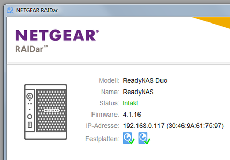

RAIDar 6.3 identify my ReadyNAS my network but administration is not possible
I try to administrate bei ReadyNAS with RAIDar or via https:\\...\admin but an error occurs. What shall I do?

Hi Hopchen!
PC and ReadyNAS are connected via LAN to the same router.
I can see the files on my ReadyNAS but the administration is not possible.

FWIW, You have a Duo v1 (running 4.1.x).
Often your symptoms are caused a by filling OS partition. This isn't your data volume, it's a different partition on your disks (and is 2 GB in size).
This can be confirmed and fixed with ssh access, but now is not the time to learn linux. There are two other options:
-contact paid Netgear support (my.netgear.com), and ask for per-incident support.
-back up the data on your NAS, and then do a factory reset. That will wipe your NAS. Then set it up again and restore the data.
I suggest doing the backup right away, even if you do want to use Netgear support. If it is a filling OS partition, it will get worse (and you will lose access to the data).
