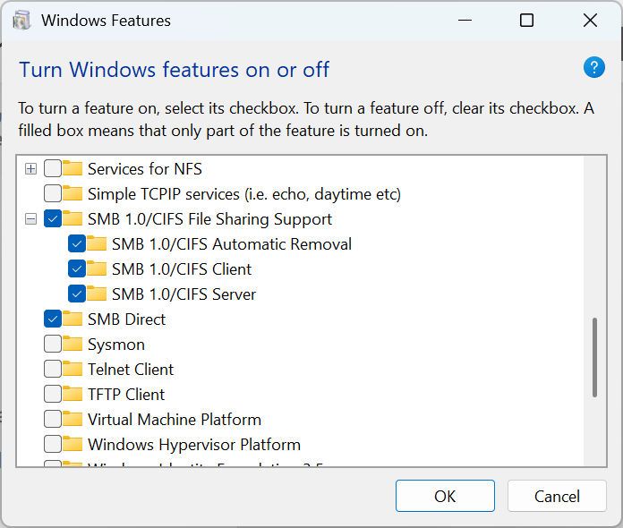

- ukbobrecover01Sep 24, 2026Aspirant
Hi to Sandshark & schumaku
Thanks for replying to my post, for which I am grateful. However, I must say this first of all, nowadays I am a firm believer, and practitioner, in the KISS principle, i.e. Keep It Simple Stupid. Therefore, I do not explore my HOST file, mess around with IP addresses, fixed or otherwise, nor do I look into the weeds of windows unless I have to.
Way, way back in the day, when I was a much younger man, I am 70 now, I would have explored those things you guys have mentioned.
Anyway, saying all that, I stick to the IP addresses my router assigns to my six Netgear NAS devices (3 x RNDuoV2, 2 x RN102 and 1 x RN104). And so far that has worked out fine for me and, in most cases, i.e. five of my six devices, still works out fine until a windows 11 update rendered my first RNDuoV2's Plex icon (the one with the Name that differs from the Mac address) from accessing the Plex database on that device. However, I can still access that NAS's dashboard via it's bookmarked icon, and BTW, both icons (bookmarked and Plex) both contain the same IP address.
Another point, all my RNDuoV2's have all been set up with Plex in exactly same way so, apart from the Name-Mac Address thing, I can't see why my windows 11 PC cannot/will not access my Plex database on that particular device.
OK, moving on, as you can see below:-
My SMB facilities, in PC's "Windows Features" have been turned on, this was done some time ago thanks to advice supplied by this forum.
Likewise, the SMB facilities in all my NAS devices are also turned, which was done as part of my original setup procedures.
So at this point, I believe that a Windows 11 update has triggered some sort of security feature that prevents my Plex icon, on my No. 1 RNDuoV2, from accessing the Plex database on that device, while all my other NAS devices remain unaffected.
