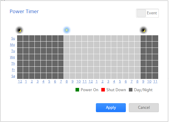

Both NAS Units are powered off either by several presses of the power button, or if left on, the unit will switch off automatically at 3am via the inbuilt software power timer... Following this at 3.10am mains power automatically switches off to the unit via a
timer. This inhibits the unit from automatically turning back on again due to the poorly designed built in power timer which doesn't allow discrete off and on timers.

This inhibits the unit from automatically turning back on again due to the poorly designed built in power timer which doesn't allow discrete off and on timers.FWIW, Current firmware does allow you to schedule discrete off and on power events.
