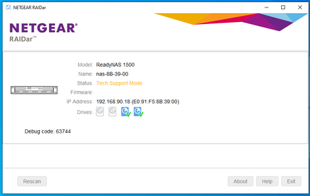

Readynas 1500 No Access on normal mode
Hello Everyone my department got an Readynas 1500 which is not working properly and i tried many ways to fix it but still cant get access to it the problem is it will only get IP address on ...

the problem is
it will only get IP address on TECH Support and Formatting mode
On normal mode it doesn't get IP add and Raidar can't locate it
