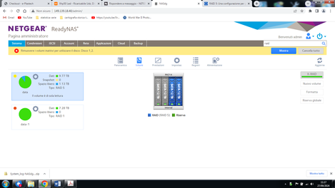

massimo127 wrote:
I supposed that the small empty space in the (RAID5) NAS was a matter.
That could be related. I am puzzled by the 10% (1.2 TB) figure, since the volume is 36 TB, so the percentage would actually be 3%.

You are right, the small empty space was quite odd! I checked the disk configuration and found that only two 12Tb volumes are actually in RAID5, the other two (12 Tb each) are marked as RAID1 (see picture). Before the upgrade with 12Tb HDs I had under raid5 all the 4Tb HDs. I'm just an 'user 'of the NAS, not an expert at all... Could I convert to raid5 the entire volume set without losing data? Any help is welcome!
cheers
