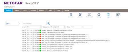

Readynas 214 shut Down for high temp
Just wondering what would cause my HD temps to rise. My Nas shut down due to all of the HD reporting too high if temp. This happened when i was not home but AC was on. Unsure of room temp but s...

StephenB So after a couple of weeks, i got the idea of what is causing the issue. it seems to be immediately after the defrag completes (not sure why I posted nothing was using drives above, I guess I forgot). It also appears that all the disk drives get too hot. Originally I had a scheduled rclone doing something at 2 on wednesdays, but I moved that to thursdays. The problem stayed on Wednesday.
- SandsharkAug 18, 2021Sensei
Why are you defragmenting so often? Frankly, I don't defrag my NAS at all. Its effect on a RAID volume is far less than on a single drive, especially when using COW, and it's not like I execute programs from it or it contains a swap file used externally.
- StephenBAug 18, 2021Guru - Experienced User
I do defrag mine every 4 months, though I agree it is only rarely needed. It doesn't seem to do any harm on my systems, so I've just kept it in the maintenance task rotation.
I get the "don't do that if it breaks your system" advice, but I am puzzled on why the defrag takes so long, and what exactly is generating the high temp. The last one I ran completed in less than 15 minutes.
I am thinking you might want to try running the disk test from the volume settings wheel, and see if the temps also rise that way. Maybe try checking it every 15 minutes or so, and if you see it approach the shutdown threshold then shutdown the NAS for a bit and let it cool off. The shutdown should also cancel the test.
