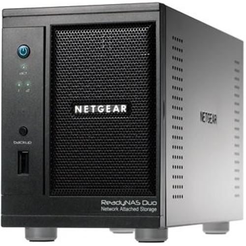

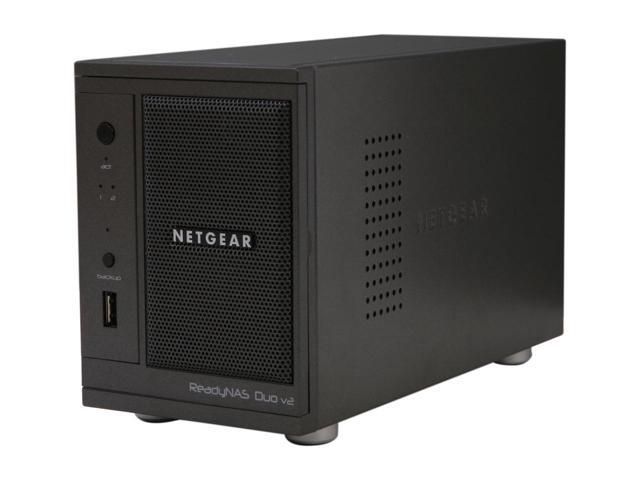

    You do need to be careful here, as the labels on the back and rear are misleading.  A "Duo v2" runs 5.3.x firmware, and says "v2" on the front of the chassis as shown below.
    A Duo v1 runs 4.1.x firmware and just says duo on the front chassis, as shown below.
    You can't migrate disks from a Duo to a Duo v2 (or vice versa). They are very different platforms.

    • pjrothwell's avatar
      pjrothwell
      And thanks for the warning about misleading model number stickers StephenB.  There is no "V2" on the front of my unit, so it seems I probably have the original version.  Very confusing!
