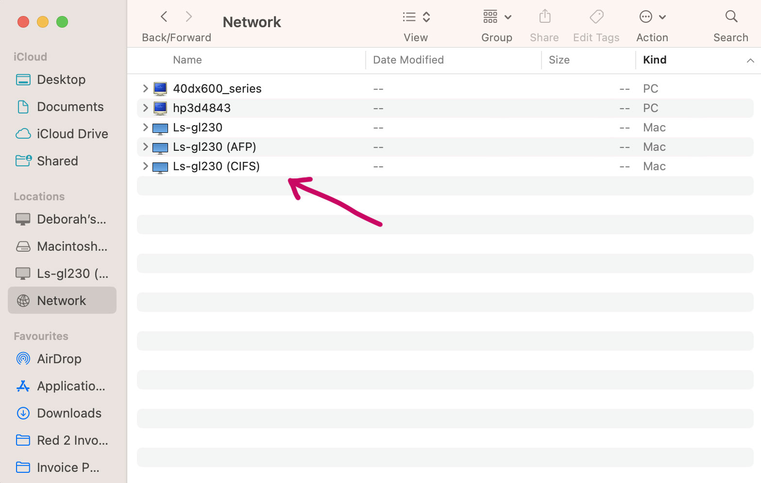

  • Hi, have a Netgear ReadyNAS Duo v2 RND2000-200EUS (working) and recently had a new Asus router. I now can't connect to the ReadyNAS Duo v2 where all my work is stored, I can see it in Network but it won't connect. Any ideas how I can connect? I'm on a Mac, the firmware doesn't work for this model either! So I'm at a loss.
    • schumaku's avatar
      schumaku
      red2design wrote:
      ... Netgear ReadyNAS Duo v2 RND2000-200EUS (working) and recently had a new Asus router. I now can't connect to the ReadyNAS Duo v2 where all my work is stored, ...
      Same IP address, and same IP subnet, as before on the original router and LAN? Static IP configured (as before), and adopted the previous router LAN IP subnet addressing?
      • red2design's avatar
        red2design
        Hi and thank you for replying. Yes with help from my ISP...
        "Try changing the LAN IP to 192.168.2.1 and the DHCP start with 192.168.2.20 ending address 192.168.2.200. Hopefully then you will be in the same subnet as the Netgear NAS."
        This is showing me more, I can see folders called admin, backup, home, media and share BUT I can't see my Work!!
