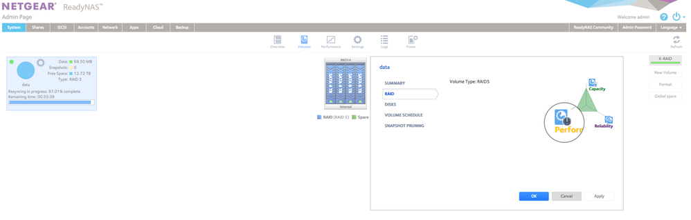

Currently have a ReadyNAS 4 bay model 314 is has 2 Western Digital 4T drives and 2 Western Digital 6T drives installed I have been trying to increase the perfromance of this device i.e  ready/write speed.  The devices are connected via a ISP modem Router rates at 1gigbit ethernet my issue recently has been with writing and deleting from this device has been slow.  The network computers are iMac's running OSX 10.12.6 connected via gigabit ethernet.  I have traced all possible avenues of where the speed can been effected the buiding's wired with Cat5e ethernet good cable. Also I notice that the device when booting slows when it reaches about 80% and seems to be working hard accessing the drives during boot with nothing to account for this.  So I decided to wipe the drives and reinstall factory settings that strips the disks using X-RAiD.  Duing the intiall factory reset the device decided to run Resyncing since their is no data on the drives I was wondering why.  I also notice a chart in the Volume's menu under setting then select RAID it shows a triangle chart that on each point of the chart indicating three states of the Raid Volume.  One state shows Performance in yellow and with a completion circle indicating decreased I assume.  I was wondering if my having 2 different Harddrive sizes installed caused degredation of the Volume perfromance and this chart is show that. Would their be any advantage to change the drives to all the same size.

    RAID operates "underneath" the file system (creating a virtual disk), so it does need to sync even if there is no data in the volume (and resync will take the same time whether the volume is empty or full).
    The performance triangle is generic - all RAID options are a balancing of performance, reliability, and capacity (though I personally think "availability" is a better term than "reliability").  So all RAID-5 systems will show the same triangle.  The mode you are using is the default, and in my opinion is the best choice for most users.

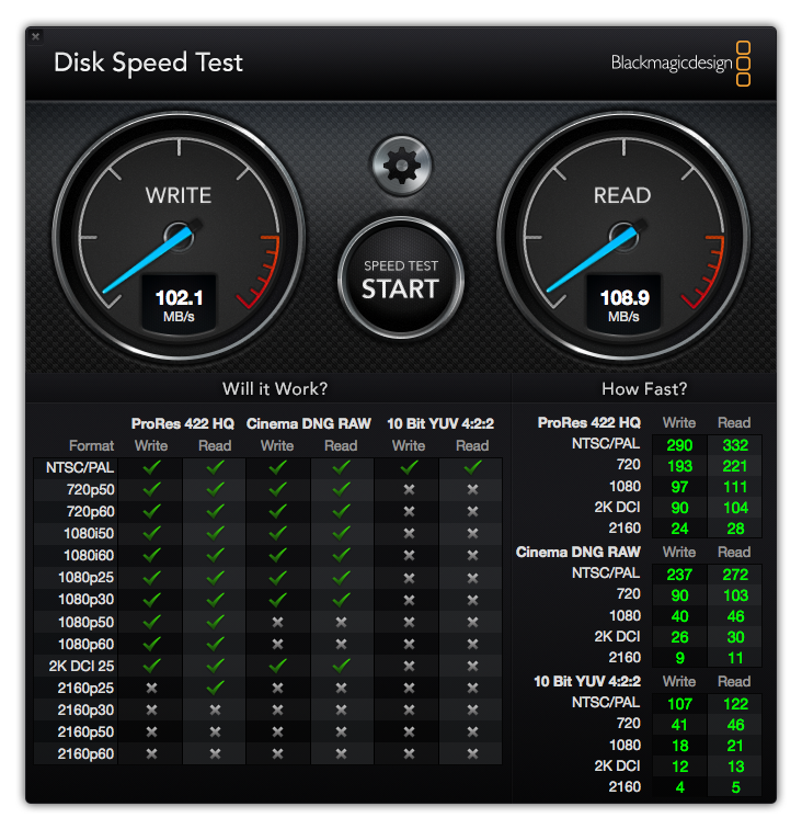

      I took the drives to the retail for testing and they came back good. Though 2 of the wentern digial 4T drives were not rated for NAS they were greens, but they all tested good.  The service clerk claims it might be the machine that is causing the error and hence the preformace indicator showing decrease.  She Claims this is common with Netgear ReadyNAS and that I might need to replace it.  I have a screen shot of read/write stress tests using a Mac app called Blackmagicdesgin Disk Tester.  Here is the results
      My issue is when I copy transfer data in large sizes i.e.  100Gig's vs say a small file around 800megs the smaller file seems to take forever to copy go figur.
