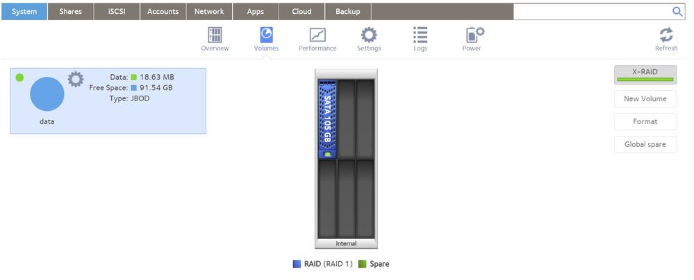

- tigertenApr 30, 2023Luminary
my Virtualbox mamchine VM has no HDD Gb limitation. Just created 100Gb and works fine. i am sure it can be even bigger.
Where is that 20 GB limitation from?
