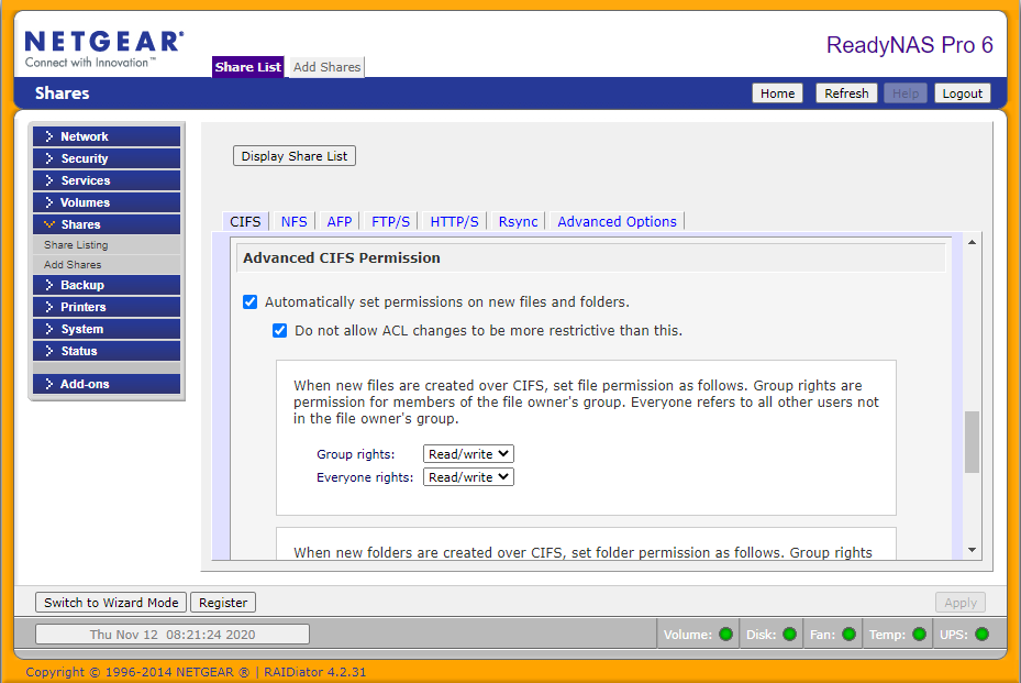

    I checked the file access rights as suggested and set all the shares to read/write with no names in the access fields ( host, read, write , groups) and checked the guest user access was disabled ( unticked). The advanced CIFS settings set to automatically set permissions for new files and folders to R/W for group and everyone. I also turned off Opportunistic locking as I wondered if Windows 10 could be unhappy about local caching of files. But with no difference. Windows gives the same error 'resource not available'.

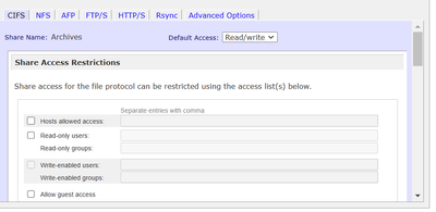

    Frontview share access for this share shows this. Do I need user names here?

    • StephenB's avatar
      StephenB
      No.  But you could check the guest access box, and also scroll down further and make sure that everything is set to read/write.
