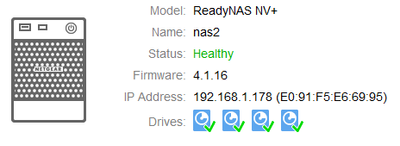

- ziemowitJan 23, 2023Aspirant
Raidar (6.3.0) shows OK, it showed version 4.1.16 of O/S before I did a reinstall some 30 minutes ago. Right now doing a FS check.
I did a new port scan, no port 80, 22 or 443 open.
Right now:
And yes, I use ssh on all NASes (NV+, RN104 and Ultra6).
