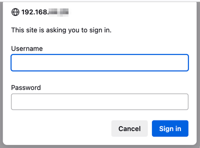

For nearly 10 years I'm a happy user of my GS105Ev2. Now I want to log into the UI again, but (of course) did not remember any credentials. I've reset the switch by pushing the reset button with a paperclip for more than 2 seconds. After a while I realized that the user manual is talking about only a password while I'm asked for a username ánd password via the browser (not sure, but I think this is because of basic authentication where is asked for by the web-server of the switch). What is going on here?
When using curl or Postman I get the following response:
<html><head>
<title>401 Authorization Required</title>
</head><body>
<h1>Authorization Required</h1>
<p>This server could not verify that you
are authorized to access the document
requested.  Either you supplied the wrong
credentials (e.g., bad password), or your
browser doesn't understand how to supply
the credentials required.</p>
<hr>
<address>Web-Smart Server</address>
</body></html>
I already have done the following:
- double checked the IP address of the switch i.c.w. the MAC-address multiple times;
- tried the default credentials: admin/password;
- tried to access the switch using both ways of connecting to the switch as described in the user manual: 1) via router using DHCP etc.; 2) directly using static IP address on laptop etc.;
- searching for the switch using the Netgear Switch Discovery Tool, but it doesn't find anything.
For all this I used a Apple Silicon MacBook and Firefox.
Does anyone has suggestions left?

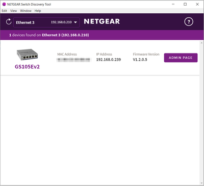

    • b-art's avatar
      b-art
      Tutor
      Hi Kurt,
      Thank you for your time.
      The product label on the back of the switch says:
      GS105Ev2
      I've managed to install the NetGear Switch Discovery Tool on a Windows machine and connect with the switch.
      As you can see firmware version V1.2.0.5 was installed.

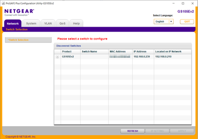

      I also installed the legacy ProSAFE Plus Configuration Utility on the Windows machine and connected with the switch.
      With this application I was able to update the firmware to the latest version: 1.6.0.11. After the update all was as it should be: when surfing to the default address of the switch I was shown the "new" UI asking me for thé password.
