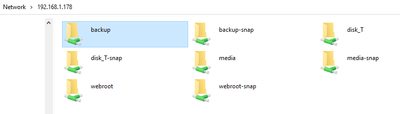

Another reboot later:
BUT... still no access. Now it won't accept username / password. As I understand, after O/S reinstall the credential information is reset to admin/netgear1 - but for some reason neither the old nor the new password (netgear1) do not work at all. 😞

But now SMB is working, so at least you can get data off the NAS.

Yes, SMB is in operation.
No, ssh won't work as nobody is listening oin port 22. I have checked again to make sure, so I have no doubt now.
I have tried both https and http protocols, but as neither port 443 or 80 have listeners on them, I get same error as previously.
I have tried following combinations when trying to access shares:
- username admin, password netgear1
- username root, password same as above
- username 192.168.1.178\admin, password as above
- username 192.168.1.178\root, password as above
- I have also tried old passwords, but they did not work.
And yes, I have noticed the change in IP-address after the reinstall, as that machine was on a fixed address before.
