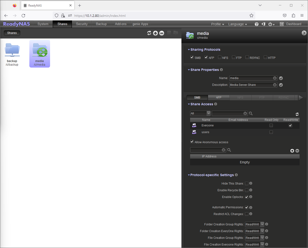

The folders on the NAS are setup up as default:
Just for kicks, I have also tried disabling my norton firewall whilst running CMD and tried uploading a file and running the windows commands, figured it wouldn't make a difference but wanted to rule it out.
- StephenBAug 26, 2023Guru - Experienced User

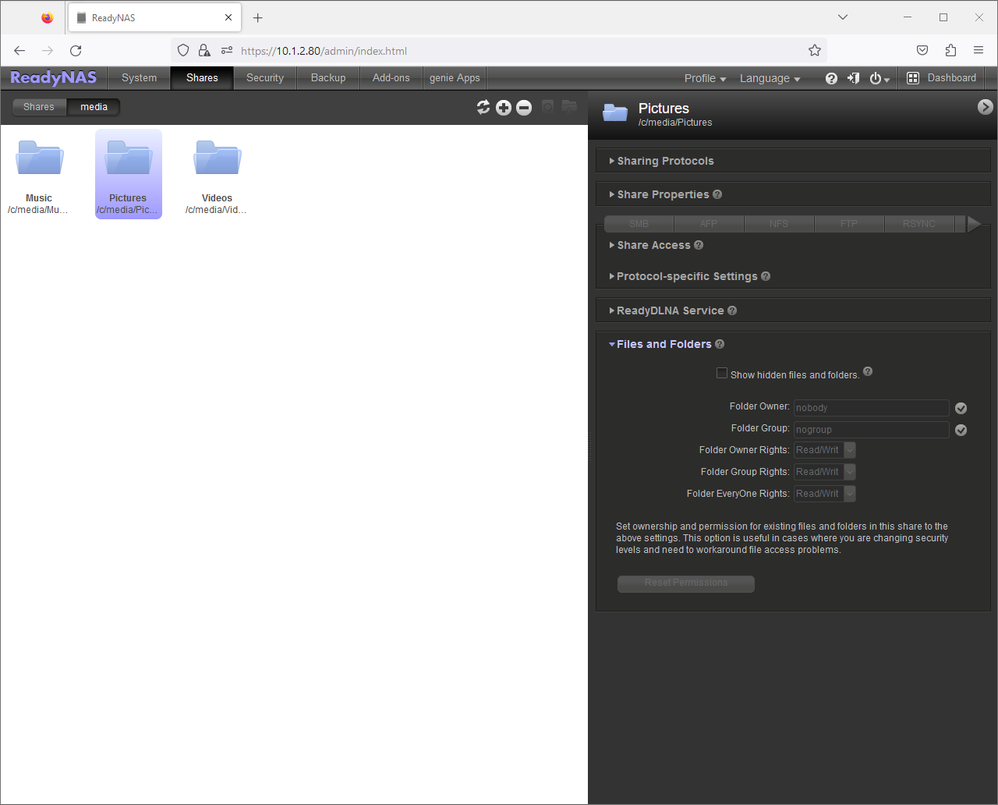

Music, Pictures, and Videos are subfolders of the media Share.
Try
net use z: \\10.1.2.80\media /u:admin password

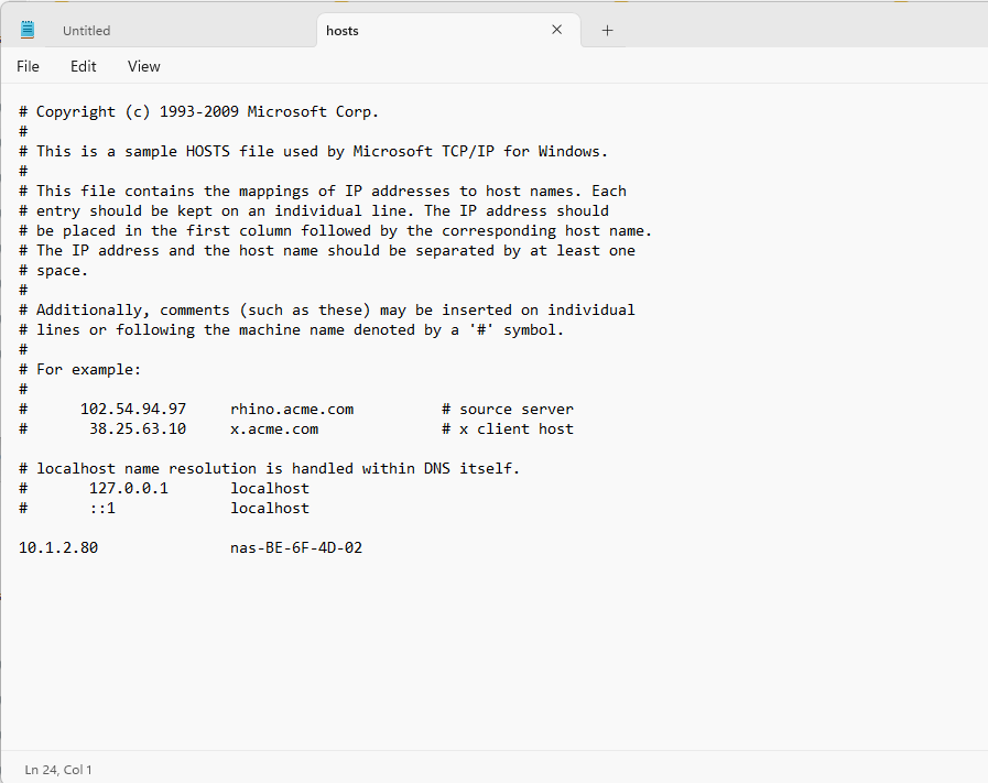

I did also try adding the DNS entry in my hosts file as (and saved etc):
but this made no difference, i also then tried inputting cmd line entry for DNS target and here is the output:

Pictures is NOT a share, it is a subfolder of the media share. You aren't using the correct path.
This one should work:
net use z: \\nas-BE-6F-4D-02\media\Pictures /u:admin password
Your second windows explorer screenshot is actually showing the ReadyDLNA media server. That is only for playback of media, there isn't any write access. If you aren't using DLNA to play the media on the NAS (for instance on a smart TV), then I recommend that you disable the DLNA service in the dashboard. That will remove the DLNA server from your network locations.

Your screen shots have not been approved, so I can't see them to see your hosts file. I hope you did Google how to do it, not just go in and try to do a normal edit. You have to edit with an editor (notepad works fine) that's launched as administrator. Otherwise, when you "saved" it, it didn't actually save.
Have you made sure that the NAS is at the IP address you put in the hosts file? Did you re-boot the PC after changing hosts?

Sorry Guys,
Working fine for the via the IP address, doesn't work via the DNS address.
# localhost name resolution is handled within DNS itself.
# 127.0.0.1 localhost
# ::1 localhost10.1.2.80(tab)(tab)nas-BE-6F-4D-02
- StephenBAug 27, 2023Guru - Experienced User
Not sure if the tabs are getting in the way or not, generally I've used a space.
What happens if you enter ping nas-BE-6F-4D-02 from the command line?
Note you don't need to stick with this hostname - you can use something simpler if you like. For instance, just nas.
You can also change this in the dashboard, to keep things consistent.
