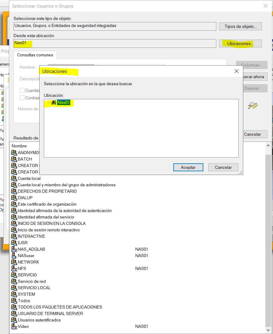

Hi all.
Just reading this document from the link below about shared resources and permissions from Active Directory, I'm not quite sure the way to do the same from Server 2019.
Setting up Active Directory folder permissions on RAIDiator 4.2 | Answer | NETGEAR Support
RAIDiator 4.2.31 (I'm afraid there is not upgrading file for this NAS)
At the point "Now you can add the security group “Domain Users” with reading-rights (allow “read”, “execute”, “list folder-contents)" I'm not capable to enter any domain users or groups from the "properties --> security tab".
As locations to find groups and / or users I only can see "NAS01" (this is my NAs name, and obviously this domain users / groups are not created inside NAS01 (please refer to the attached picture).
SMB protocol is activated on server 2019. I checked with Administrator AD acount and others, but I'm still lost to attach NAS01 to  the domain.
DNS servers and IP parameters are correctly configured, domain name too !!
Does anyone this problem? Wokaround or solutions, please?
Many thanks
Andres.
    What you missed (because the link is broken) is the part of the article that says "Windows ADS (Active Directory Service) is a supported security mode on all business-class ReadyNAS products."  The Ultra2 is not a "Business Class" unit and does not support AD.
    That is the last official OS for the Ultra series.  Assuming the NAS is an Ultra 2 (you selected Duo for display in your signature), then your unit can be updated to OS6.  That configuration is not officially supported by Netgear (you lose access to Netgear support), which is not an acceptable situation for many businesses, and you have to offload the data and restore it after the conversion.  But you do gain everything that a native OS6 NAS has over an old 4.2.x one, SMB3 being an important one for many businesses.  And more important to you, no differentiation fo "business class" units -- you will have AD support.  You also gain easy replacement by a native OS6 unit if the Ultra fails or you just want a more powerful NAS.
