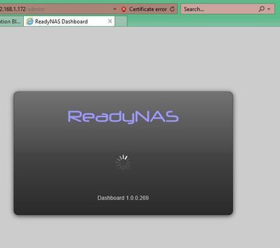

readynas+ V2 RND400 web interface stuck
I'm having trouble with my readynas+ v2, when trying to access via web interface (only can use internet explorer because security certificate error with other browsers). The interface gets stuck/froz...

Thanks Stephen,
I have checked with Raidar and the Nas firmware version is 5.3.8 and shows healthy as shown in pic.
Is there a way to upgrade nas firmware without using web interface?
I tried seeing if this has a usb boot but seems like there is no option.
No easy way. Back up the files first, and then we will see.
Have you tried "compatibility view"? https://csuf.screenstepslive.com/s/12867/m/48642/l/979585-changing-compatibility-view-in-internet-explorer
- Simmo_79May 09, 2022Aspirant
Stephen, you are a gun.
Adding the Nas IP address to this setting has done the trick.
Thank you so much for your assistance.
