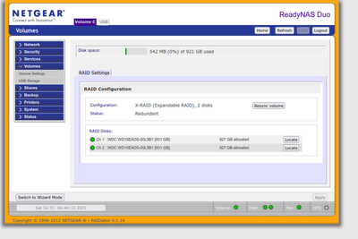

corkscrew22 wrote: Do you have any idea what might of gone wrong with the power outage ? obviousley I have lost acces to my data (although I see the disk space is still used) but the shares I set up have gone
Generally speaking, the problem is caused by lost writes (which were cached, but never written to the disk). That can lead to a corrupted volume that can't be mounted. I always recommend connecting a UPS to the NAS to prevent this - the UPS ensures that the NAS can shut down cleanly when the power fails. FWIW, I once lost a volume on my own Duo due to an unexpected power loss. That triggered my investment in UPS.
I think there was a good chance we could have recovered the data if you hadn't done the reset, but it's hard to say for sure. RAID Recovery software (perhaps R-linux for Windows) might still be able to find it. But if you want to try that, then power down the NAS, as the more disk writes that happen, the more unlikely recovery is.
If you did a factory default (and it sounds like you did), then the disk space isn't used, and the data is gone. The disks are formatted as part of the process. There is some space usage that shows up in Frontview, but that isn't real - it's reserved by the NAS. If I recall correctly, it will show about 20 GB of used space after setup completes. Your setup screen is showing 0% used.
