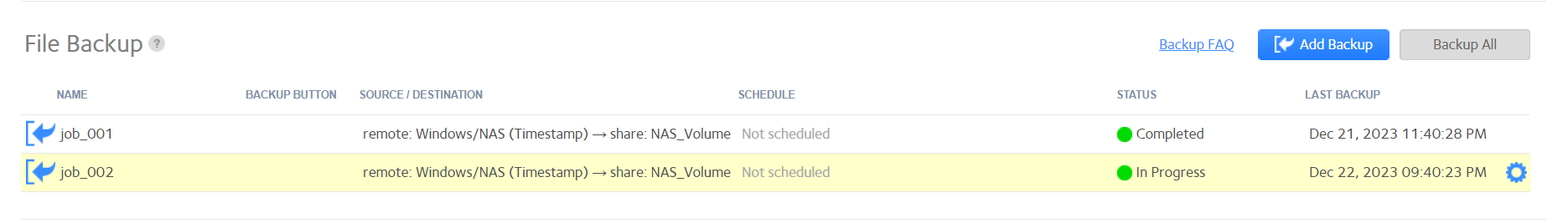

i have 2 individual Netgear RN214
and i already installed Zerotier on both Devices. and its working perfectly fine.
i can connect with my ReadyNAS 214 with Zerotier in Browser.
now. my question is how do i data backup with zerotier.
Or Schedule backup which i attached below.
Please enlighten me.

I am assuming you want to do a NAS->NAS backup. The main thing is to use the remote NAS ZeroTier IP address for the backup host.
There are several options on the choice of backup protocol and settings. It'd be best if you read through the KB articles and the software manual.

But to get you started, here is what I do myself:
My aim is to be able to immediately switch to the backup NAS if something goes wrong with the primary NAS. I set up one backup job for each share (and set up the same shares on the backup NAS as I have on the primary one). My backup jobs are running on the destination NAS (which I call a "pull" backup). This allows me to put the destination NAS on a power schedule. The protocol I use is rsync, and this is set up to give me a mirror of what is on the primary NAS share. I also set up custom snapshots on the destination NAS to give me some retention (so I can roll back if I accidentally delete something).
I believe Sandshark's approach is different, I'll leave it to him to share what he does. Both our approaches work (and there are other options also).
Here are screenshots of my backup job settings for one of my shares:
And here are my snapshot settings for the destination share (from the shares page):
Obviously you can set up longer (or shorter) snapshot retention as desired.
