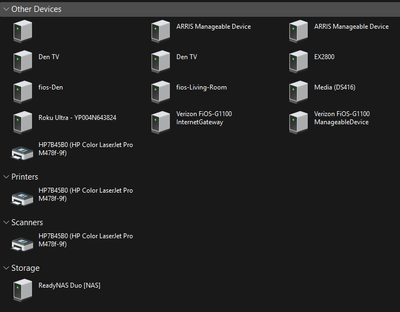

Hi all,
I have a very old ReadyNas Duo that I would like to retire, but I urgently need to remove and safeguard the data from it. It will boot and the device is visible on the network, but I cannot access it via Windows 11 in any manner. I expect it has something to do with security permissions, but I'm not savvy enough to understand any of this. I'm just a regular homeowner-user who had backups set to it on a now long-gone computer.
Is there any way to mount these under Windows directly, or any way to be able to simply copy/paste the folders and files onto an external hard drive? I'm not interested in writing to the NAS again, just one, final read and that'll be that for it.
Please and thanks.

      The first part (enabling SMB) didn't work. The second one I have no idea what that is. I downloaded something called RLinux6_i386.deb but I don't know how to open it. I've never even seen Linux in operation so I don't know what to do with it. The drive does work inside the case as a SATA device, and using a partition program I can see the partitions but that's as far as I can go.
      I can "download" individual files if I enter 192.168.1.9 and log in with my credentials, but it comes up in a browser window, not under This Computer. I cannot download folders in this manner. The device does show up as a Storage device but I cannot access it.
      Entering \\NAS just returns an error, and the IP address opens it in a browser.
