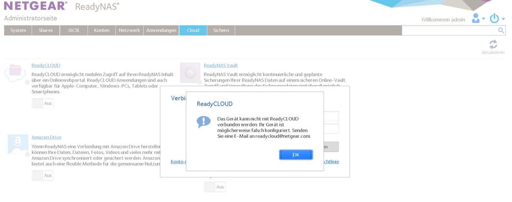

When i try to connect to READYCLOUD i get the following answer

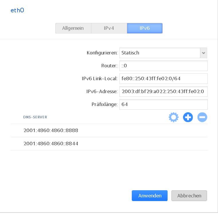

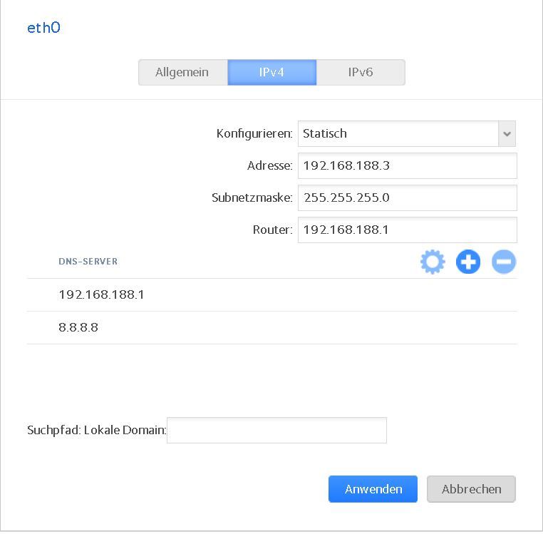

i use a static IP address
with IP v6
and
for IP v4
