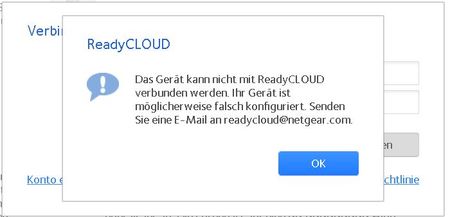

When i try to connect to READYCLOUD i get the following answer
i use a static IP address
with IP v6
and
for IP v4
Jochen
- StephenBNov 26, 2018Guru - Experienced User
Does anything change if you disable ipv6 in the NAS?
Also, can you confirm that the NAS is reaching the internet? Turning NTP off and on again is one easy way to check.
