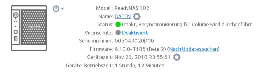

Nov 25, 2018RN 10200 Serialnumber shown is: N0NE000200000 correct is 3ERB49EM00A83; MAC-Address is not correct
I bought the RN10200 over ebay some days ago
On the bottom i see
Produkt: RN10200
Seriennummer 3ERB49EM00A83
MAC 28:C6:8E:36:FD:45
FW: V 6.1.8
It was bought
2014-12-07
and registered ...

Retired_Member
Nov 26, 2018Hello Stephen
I set the nas back to factory settings

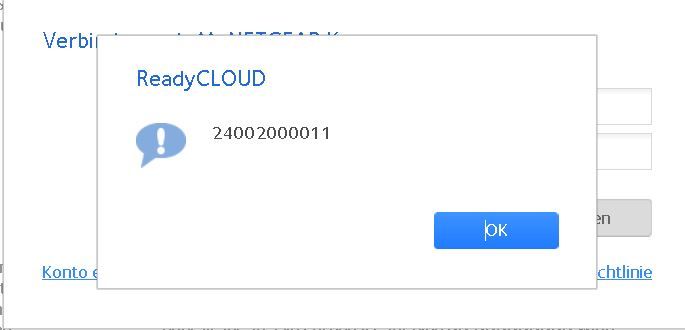

Afterwords the serialnumber show the ethernet-adress and i get 24002000011 when i try to connect to READYCLOUD
I read that mdgm-ntger, a NETGEAR Employee, has a solution for this problem
Thanks in advance
Jochen

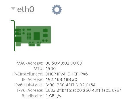

- Retired_MemberNov 27, 2018
The NAS is connected via a switch to a Fritzbox 7490.
The Fritzbox assigns the NAS an IP address.
I have registered DNS Server 8.8.8.8 and also 8.8.4.4.
When I try to connect to READYCLOUD I get the message 24002000011.
The problem seems to be that the Nas also enters the Ethernet address 00: 50: 43: 02: 00: 00 as a serial number,
although on the device on the bottom this
Serial number 3ERB49EM00A83
and this
MAC address 28: C6: 8E: 36: FD: 45
are registered.
If I change the IP address to static, the serial number immediately changes to NONE000200000.
Then I get the message when I log in to READYCLOUD that the NAS is configured incorrectly.
Jochen
