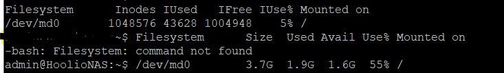

- hoolio84Dec 28, 2020Guide
This is the result. What do you mean?
StephenB wrote:
hoolio84 wrote:But how could this happen?
I don't know the mechanism that caused it, but what happened is that some configuration files were corrupted somehow.
You might want to check on how full the OS partition is.
# df // -h # df // -i
Normally it is less than 25% full, and uses around 2% of the available inodes.
