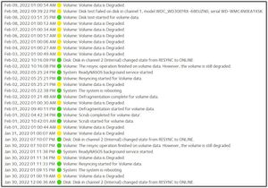

RN102 disk1 Degrading after adding new disk for raid1
RN102 fw:6.10.6 with WD-Red 3TB, working 6yrs with spotless logs. Installed another WD-Red 3TB in slot 2, and changed X-RAID to FLEXRAID = Raid1. Immediately I got a yellow warning that disk1 was d...

I have gone through the extended logs, but allthough I haved worked in IT right up to my pension, I do not know exactly what I should be looking for in the logs.
So I take the liberty to forward extracts from some of the log-postings on my OneDrive:

Søren- StephenBFeb 12, 2022Guru - Experienced User
sda (the first disk) failed the most recent self test, and is showing read errors in the kernel log (perhaps other places).
One thing you could try is powering down the NAS, and removing that disk. Then boot the system up in read-only mode, and verify that you can access the data. If you can, the step after that would be to make sure you have a current backup.
